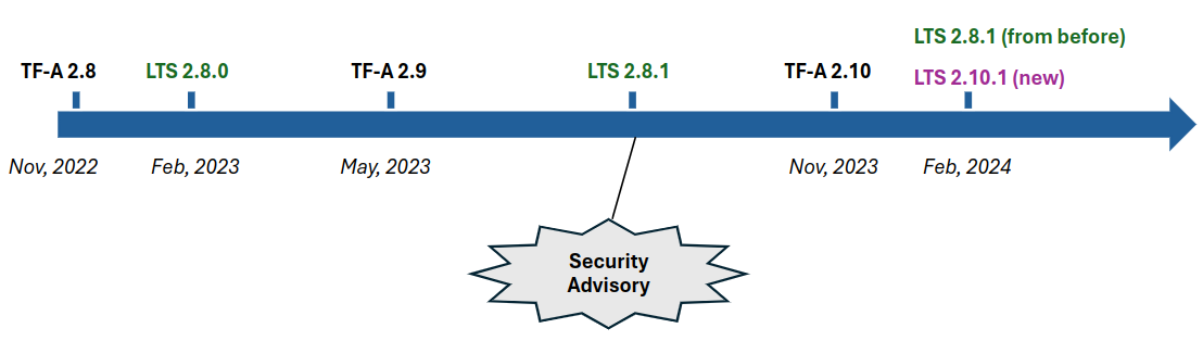

Example timeline
Below is an example timeline starting from the November 2022 release of TF-A.
../_images/lts-timeline-example.png
  • Nov 2022: TF-A 2.8 is released towards the end of Nov, 2022. Not shown in the diagram, at the same time LTS release candidate branch is made which is based on TF-A 2.8. This means new features going in 2.8 won’t go in the LTS branch. We can call it LTS 2.8-rc.
  • Feb 2023: After testing and debugging LTS 2.8-rc for a couple of months, LTS 2.8.0 is officially released in early Feb 2023.
  • May 2023: TF-A 2.9 is released but since this is not an LTS branch it doesn’t affect LTS.
  • Somewhere between May and Nov of 2023: A security advisory comes up and the related patches go into TF-A master branch. Since these patches fall under LTS criteria, they are backported to LTS 2.8.0 which results in LTS 2.8.1 being released. Note that here we don’t allow the extra testing and debugging time that we had between Nov 2022 and early Feb 2023. This is because there isn’t as much to test and debug as an annual LTS release has. Also companies might want to deploy critical patches soon.
  • Nov 2023: TF-A 2.10 is released. Not shown in the diagram, at the same time LTS 2.10-rc is made. It’s tested by partners for a couple of months.
  • Feb 2024: LTS 2.10.1 is released in early Feb. Now there are two LTS branches: 2.8.1 and 2.10.1.
Note that TFTF will follow similar branching model as TF-A LTS, i.e. there will be TFTF LTS 2.8.0 in Feb 2023, 2.8.1 (if new TFTF tests need to be added for the security advisory) when there is TF-A LTS 2.8.1 and so on.
