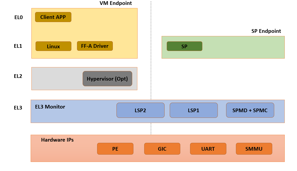

4.16.2. Sample reference stack
The following diagram illustrates a possible configuration when the FEAT_SEL2 architecture extension is not implemented, showing the SPMD and SPMC at EL3, one S-EL1 secure partition, with an optional Hypervisor:
../_images/ff-a-spm-at-el3.png

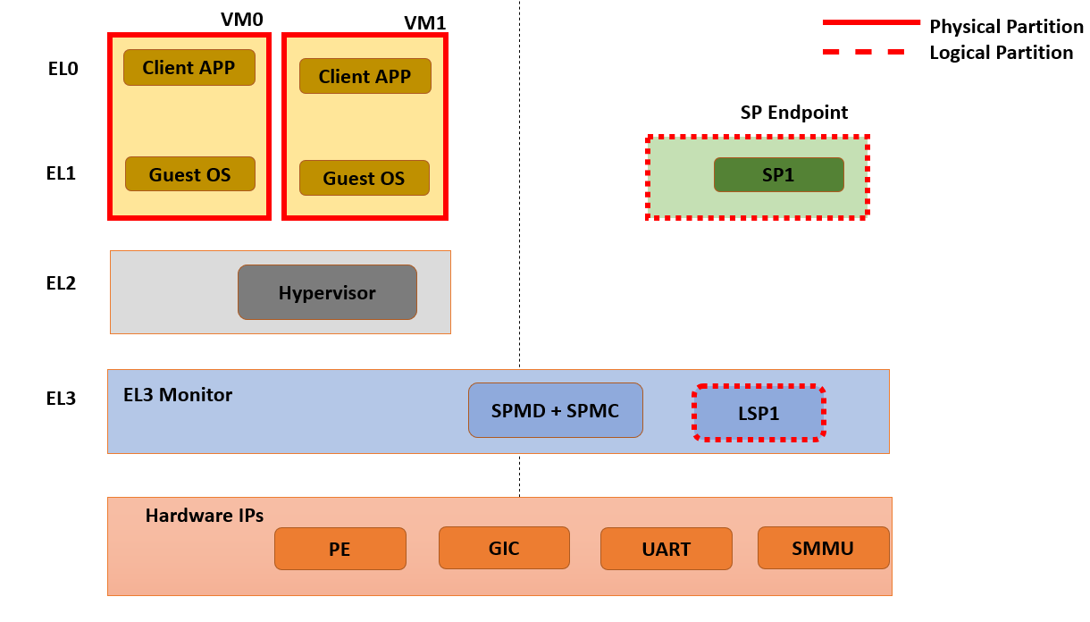

4.16.6. Logical Secure Partition (LSP)
  • The SPMC provides support for statically allocated EL3 Logical Secure Partitions as per FF-A v1.1 specification.
  • The DECLARE_LOGICAL_PARTITION macro can be used to add a LSP.
  • For reference implementation See - [2]
../_images/ff-a-lsp-at-el3.png
