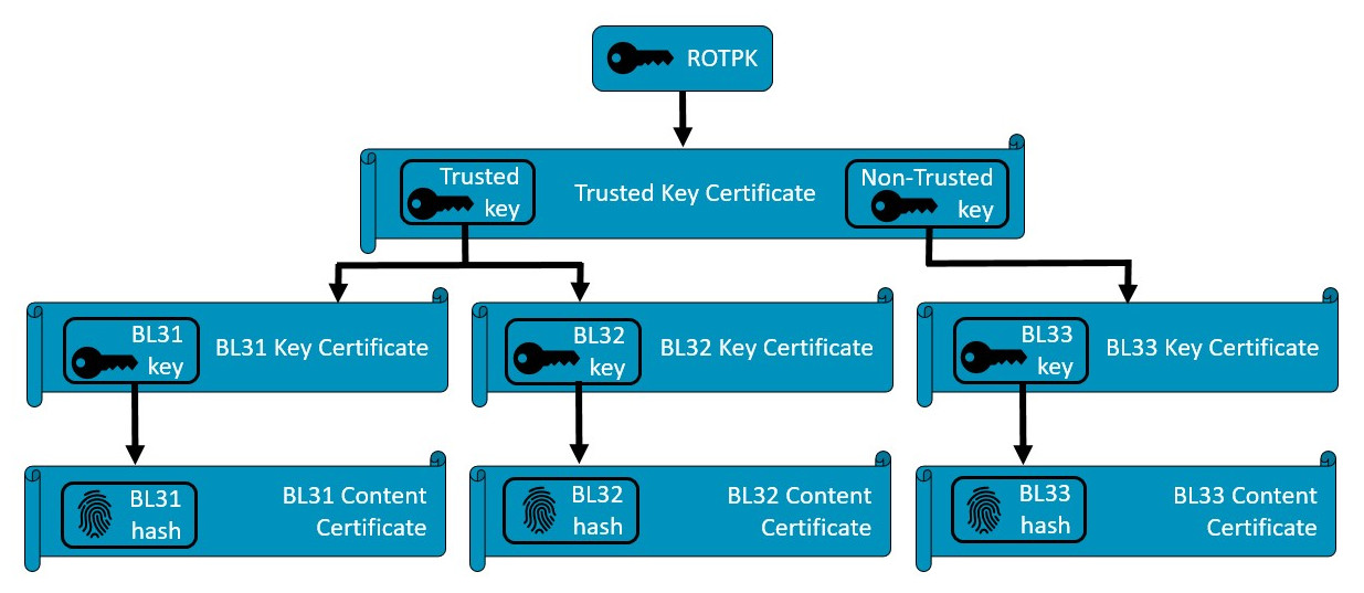

5.9.1.1. Default CoT #1: TBBR
The TBBR CoT is named after the specification it follows to the letter.
In the TBBR CoT, all firmware binaries and certificates are (directly or indirectly) linked to the Root of Trust Public Key (ROTPK). Typically, the same vendor owns the ROTPK, the Trusted key and the Non-Trusted Key. Thus, this vendor is involved in signing every BL3x Key Certificate.
The keys used to establish this CoT are:
  • Root of trust key
    The private part of this key is used to sign the trusted boot firmware certificate and the trusted key certificate. The public part is the ROTPK.
  • Trusted world key
    The private part is used to sign the key certificates corresponding to the secure world images (SCP_BL2, BL31 and BL32). The public part is stored in one of the extension fields in the trusted key certificate.
  • Non-trusted world key
    The private part is used to sign the key certificate corresponding to the non-secure world image (BL33). The public part is stored in one of the extension fields in the trusted key certificate.
  • BL3X keys
    For each of SCP_BL2, BL31, BL32 and BL33, the private part is used to sign the content certificate for the BL3X image. The public part is stored in one of the extension fields in the corresponding key certificate.
The following images are included in the CoT:
  • BL1
  • BL2
  • SCP_BL2 (optional)
  • BL31
  • BL33
  • BL32 (optional)
The following certificates are used to authenticate the images.
  • Trusted boot firmware certificate
    It is self-signed with the private part of the ROT key. It contains a hash of the BL2 image and hashes of various firmware configuration files (TB_FW_CONFIG, HW_CONFIG, FW_CONFIG).
  • Trusted key certificate
    It is self-signed with the private part of the ROT key. It contains the public part of the trusted world key and the public part of the non-trusted world key.
  • SCP firmware key certificate
    It is self-signed with the trusted world key. It contains the public part of the SCP_BL2 key.
  • SCP firmware content certificate
    It is self-signed with the SCP_BL2 key. It contains a hash of the SCP_BL2 image.
  • SoC firmware key certificate
    It is self-signed with the trusted world key. It contains the public part of the BL31 key.
  • SoC firmware content certificate
    It is self-signed with the BL31 key. It contains hashes of the BL31 image and its configuration file (SOC_FW_CONFIG).
  • Trusted OS key certificate
    It is self-signed with the trusted world key. It contains the public part of the BL32 key.
  • Trusted OS content certificate
    It is self-signed with the BL32 key. It contains hashes of the BL32 image(s) and its configuration file(s) (TOS_FW_CONFIG).
  • Non-trusted firmware key certificate
    It is self-signed with the non-trusted world key. It contains the public part of the BL33 key.
  • Non-trusted firmware content certificate
    It is self-signed with the BL33 key. It contains hashes of the BL33 image and its configuration file (NT_FW_CONFIG).
The SCP firmware and Trusted OS certificates are optional, but they must be present if the corresponding SCP_BL2 or BL32 images are present.
The following diagram summarizes the part of the TBBR CoT enforced by BL2. Some images (SCP, debug certificates, secure partitions, configuration files) are not shown here for conciseness:

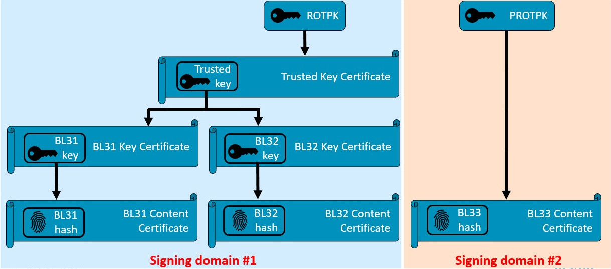

5.9.1.2. Default CoT #2: Dualroot
The dualroot CoT is targeted at systems where the Normal World firmware is owned by a different entity than the Secure World Firmware, and those 2 entities do not wish to share any keys or have any dependency between each other when it comes to signing their respective images. It establishes 2 separate signing domains, each with its own Root of Trust key. In that sense, this CoT has 2 roots of trust, hence the dualroot name.
Although the dualroot CoT reuses some of the TBBR CoT components and concepts, it differs on the BL33 image’s chain of trust, which is rooted into a new key, called Platform ROTPK, or PROTPK for short.
The following diagram summarizes the part of the dualroot CoT enforced by BL2. Some images (SCP, debug certificates, secure partitions, configuration files) are not shown here for conciseness:
