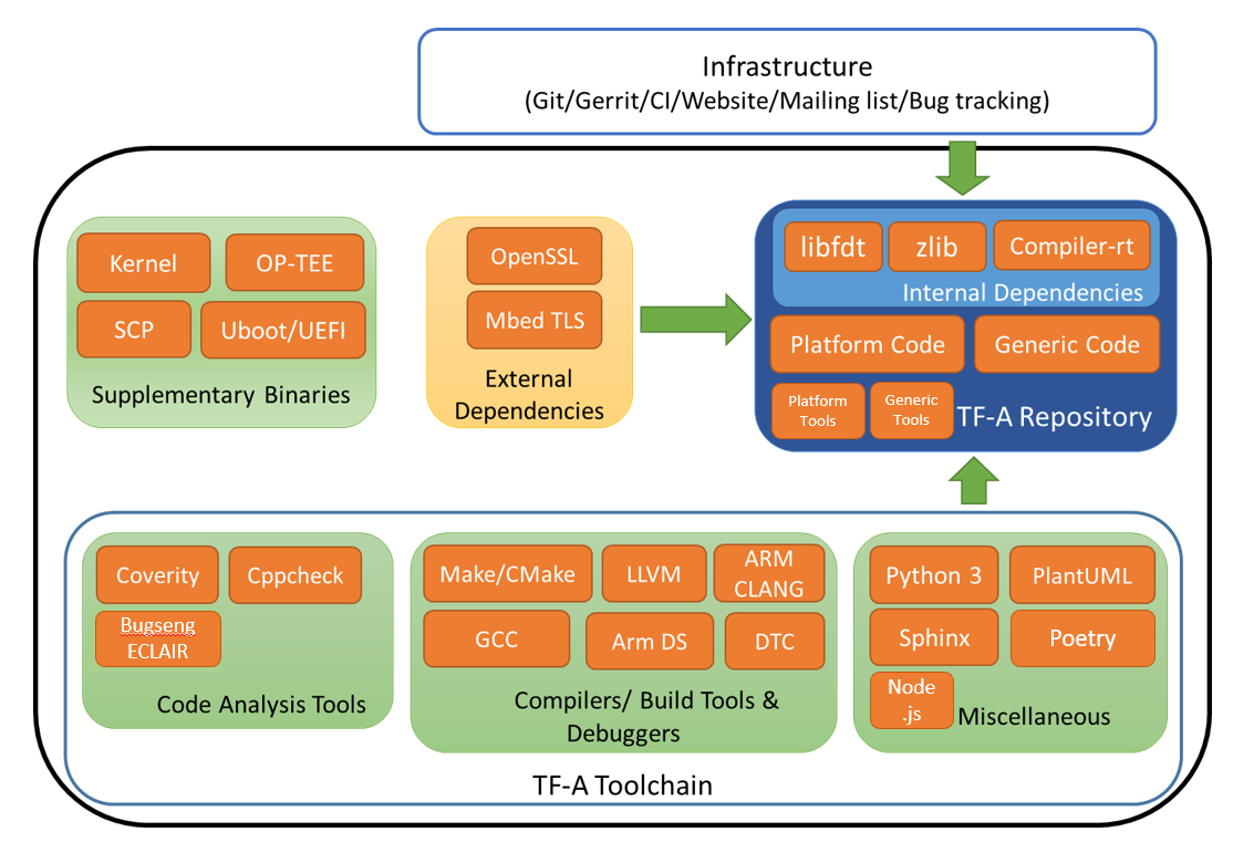

11.2.2. TF-A Overview
Figure 1 shows the different software components surrounding the TF-A project. A brief description of each component is provided below.
11.2.2.1. TF-A Repository
The TF-A repository contains generic and platform code contributed by TF-A contributors as well as libraries imported from other open-source projects, referred to as internal dependencies on Figure 1. These libraries include:
  • libfdt: libfdt is a utility library for reading and manipulating Device Tree Binary (DTB) files. It is part of the Device Tree Compiler (DTC) toolchain [1]. DTC is used as part of the build process on the host machine to build DTB files. libfdt is used to parse the DTB files at boot time.
  • zlib: zlib is a data compression library imported from [2].
  • compiler-rt: This is a collection of runtime libraries from the LLVM compiler infrastructure project [3]. We import the builtins library which provides low-level, target-specific compiler builtins from compiler-rt.
The TF-A repository also includes source code for host tools that supplement the TF-A build process. These tools include:
  • fiptool: This tool is used to create a Firmware Image Package (FIP) which allows for packing bootloader images into a single archive that can be loaded by TF-A from non-volatile platform storage.
  • cert_create: This tool is used to generate certificates for binary images.
  • encrypt_fw: This tool takes the plain firmware image as input and generates the encrypted firmware image which can then be passed as input to the fiptool utility for creating the FIP.
  • sptool: This tool is used to build the secure partition packages.
TF-A System Diagram Figure 1: TF-A System Diagram

11.2.2.3. Supplementary Binaries
These are binaries used to test TF-A based systems. Below is a brief description of each component and where they are sourced from.
  • SCP-firmware: For our tests, we use SCP-firmware binaries supplied by the Arm SCP team built from the source from the GitHub repository [6].
  • OP-TEE: Trusted Execution Environment (TEE) from tf.org that runs as Secure EL1. We use OP-TEE built from source or binaries supplied with Arm Reference Platforms depending on the test configuration.
  • EDK2 UEFI: Normal world bootloader from the EDK2 project [7]. We use EDK2 UEFI binaries hosted on tf.org servers for testing [8].
Other software components used to test TF-A include U-Boot, Linux kernel, RSE, MCP, and file systems, all sourced from the Arm Reference Platforms teams.
11.2.2.4. TF-A Toolchain
The TF-A project uses several tools to build, analyze and test the TF-A source code.
11.2.2.4.1. Node.js Tools
These are optional quality assurance and developer utility tools that are installed through the use of the Node.js package manager. They are pinned to specific versions described by the package.json file in the root of the TF-A repository, and their dependencies are downloaded from the internet at the point of installation. These tools may be installed locally on the developer machine and are installed within a Docker container in certain CI jobs. At present, these are:
  • Commitlint
  • Commitizen
  • Husky

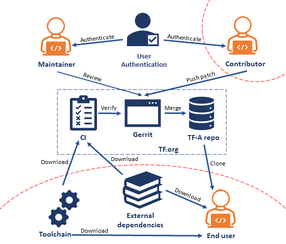

11.2.3. TF-A Data Flow
Figure 2 below shows the data flow diagram for TF-A. The broken red lines indicate trust boundaries.
TF-A Data Flow Diagram Figure 2: TF-A Data Flow Diagram

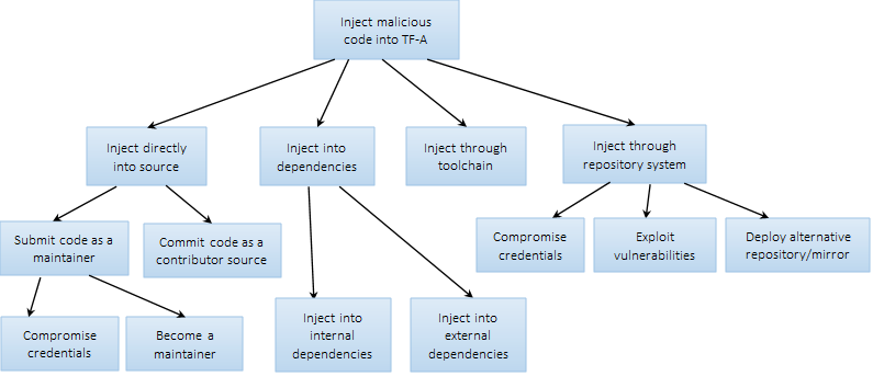

11.2.4. Attack Tree
TF-A Attack Tree Figure 3: TF-A Attack Tree
