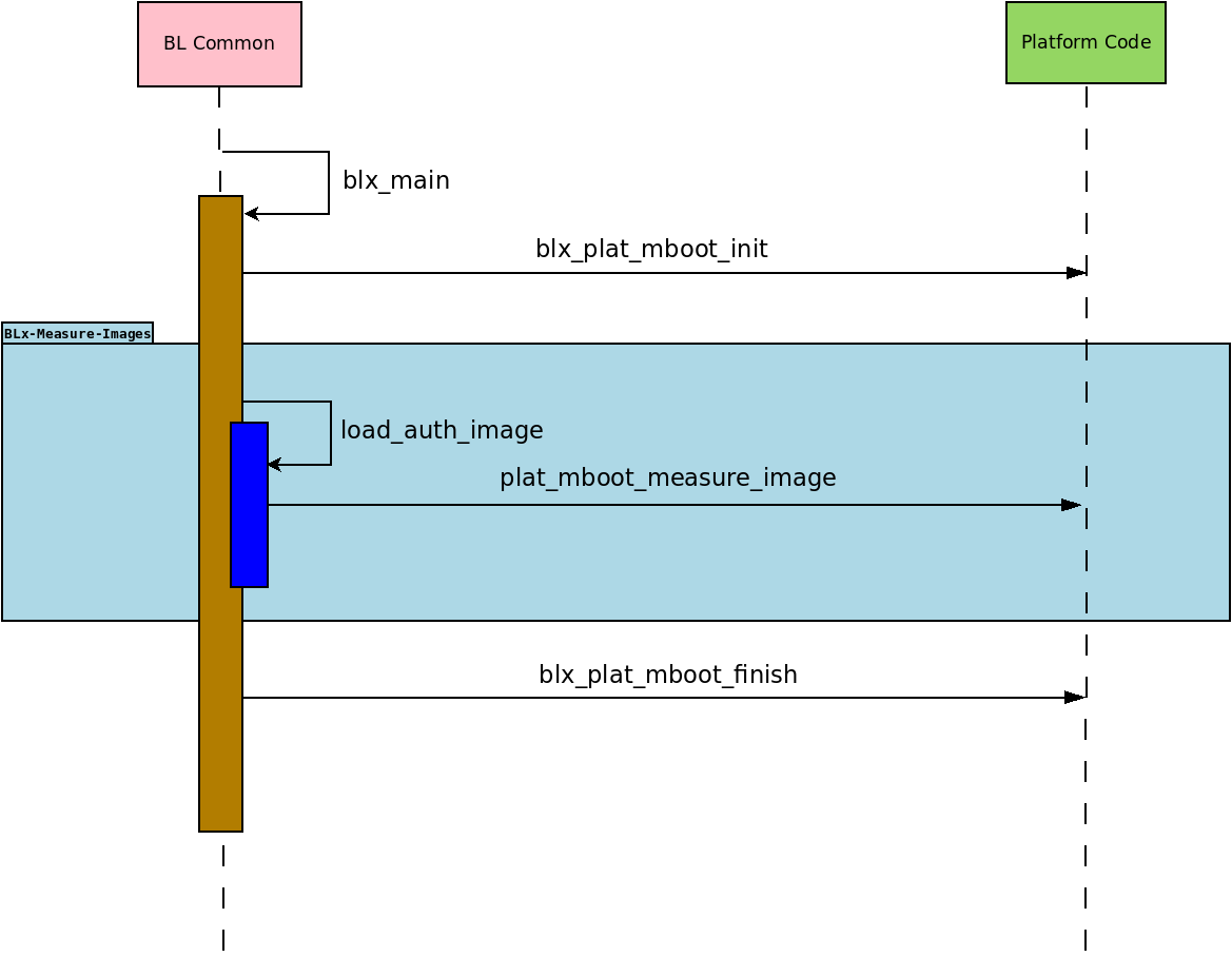

Every image which gets successfully loaded in memory (and authenticated, if trusted boot is enabled) then gets measured. In addition to that, platforms can measure any relevant piece of critical data at any point during the boot. The following diagram outlines the call sequence for Measured Boot platform interfaces invoked from generic code:
../_images/measured_boot_design.png
These platform interfaces are used by BL1 and BL2 only, and are declared in include/plat/common/platform.h. BL31 does not load and thus does not measure any image.
