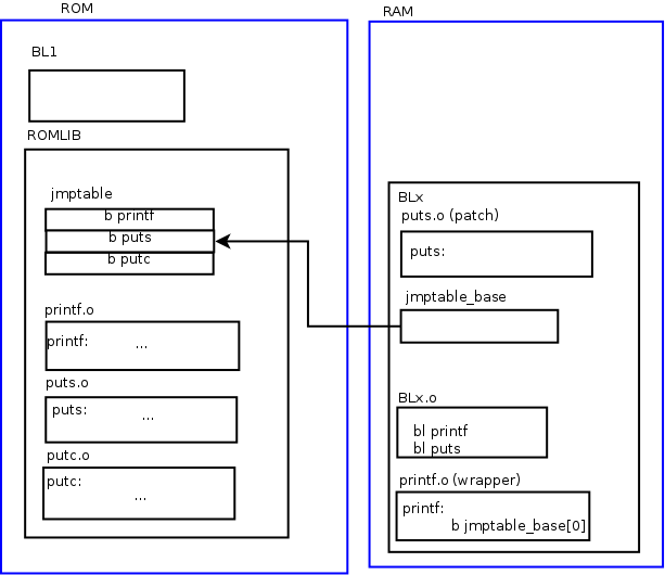

4.13.2. Index file
../_images/romlib_design.png
Library at ROM is described by an index file with the list of functions to be placed in ROM. The index file is platform specific and its format is:
lib function    [patch]
lib      -- Name of the library the function belongs to
function -- Name of the function to be placed in library at ROM
[patch]  -- Option to patch the function
It is also possible to insert reserved spaces in the list by using the keyword “reserved” rather than the “lib” and “function” names as shown below:
reserved
The reserved spaces can be used to add more functions in the future without affecting the order and location of functions already existing in the jump table. Also, for additional flexibility and modularity, the index file can include other index files.
For an index file example, refer to lib/romlib/jmptbl.i.

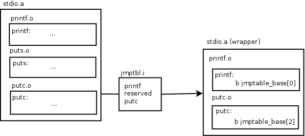

4.13.3. Wrapper functions
../_images/romlib_wrapper.png
When invoking a function of the “library at ROM”, the calling sequence is as follows:
BL image –> wrapper function –> jump table entry –> library at ROM
The index file is used to create a jump table which is placed in ROM. Then, the wrappers refer to the jump table to call the “library at ROM” functions. The wrappers essentially contain a branch instruction to the jump table entry corresponding to the original function. Finally, the original function in the BL image(s) is replaced with the wrapper function.
The “library at ROM” contains a necessary init function that initialises the global variables defined by the functions inside “library at ROM”.
Wrapper functions are specified at the link stage of compilation and cannot interpose uppon functions within the same translation unit. For example, if function fn_a calls fn_b within translation unit functions.c and the romlib jump table includes an entry for fn_b, fn_a will include a reference to fn_b’s original program text instead of the wrapper. Thus the jumptable author must take care to include public entry points into translation units to avoid paying the program text cost twice, once in the original executable and once in romlib.
