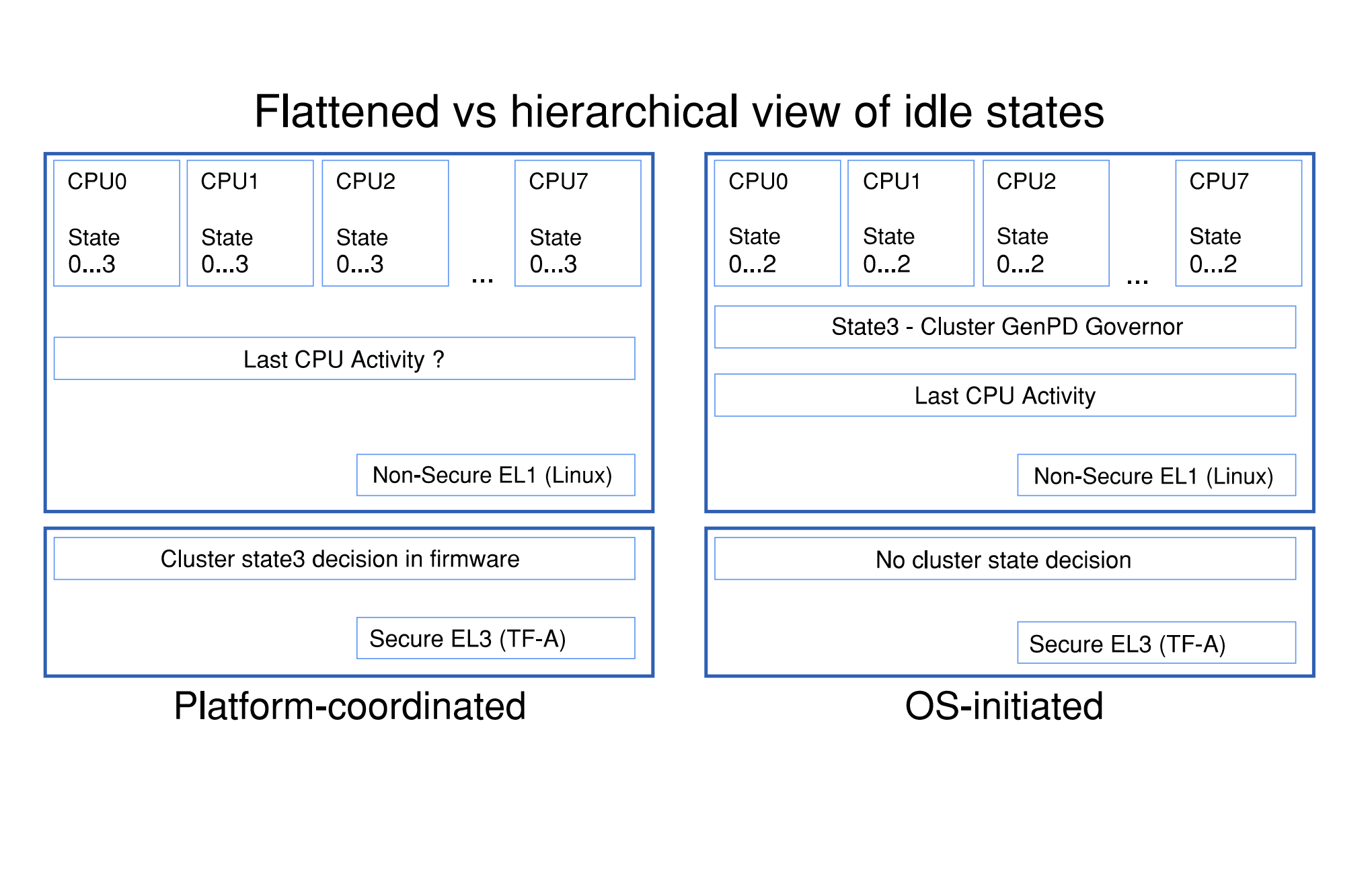

10.6.2. Motivation
There are two reasons why OS-initiated mode might be a more suitable option than platform-coordinated mode for a platform.
10.6.2.1. Scalability
In platform-coordinated mode, each core independently selects their own local power states, and doesn’t account for composite power states that are shared between cores.
In OS-initiated mode, the OS has knowledge of the next wakeup event for each core, and can have more precise control over the entry, exit, and wakeup latencies when deciding if a composite power state (e.g. for a cluster) is appropriate. This is especially important for multi-cluster SMP systems and heterogeneous systems like big.LITTLE, where different processor types can have different power efficiencies.
10.6.2.2. Simplicity
In platform-coordinated mode, the OS doesn’t have visibility when the last core at a power level enters a low-power state. If the OS wants to perform last man activity (e.g. powering off a shared resource when it is no longer needed), it would have to communicate with an API side channel to know when it can do so. This could result in a design smell where the platform is using platform-coordinated mode when it should be using OS-initiated mode instead.
In OS-initiated mode, the OS can perform last man activity if it selects a composite power state when the last core enters a low-power state. This eliminates the need for a side channel, and uses the well documented API between the OS and the platform.

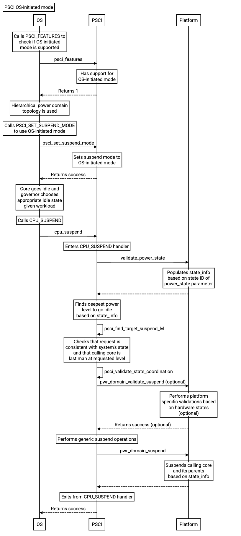

10.6.5.2. Proposed implementation of OS-initiated mode
To add support for OS-initiated mode, the following changes are proposed:
  • Add a boolean build option PSCI_OS_INIT_MODE for a platform to enable optional support for PSCI OS-initiated mode. This build option defaults to 0.
Note
If PSCI_OS_INIT_MODE=0, the following changes will not be compiled into the build.
  • Update psci_features to return 1 in bit[0] to indicate support for OS-initiated mode for CPU_SUSPEND.
  • Define a suspend_mode enum: PLAT_COORD and OS_INIT.
  • Define a psci_suspend_mode global variable with a default value of PLAT_COORD.
  • Implement a new function handler psci_set_suspend_mode for PSCI_SET_SUSPEND_MODE.
  • Since psci_validate_power_state calls a platform specific validate_power_state handler, the platform implementation should populate the state_info object based on the state ID from the given power_state parameter.
  • psci_find_target_suspend_lvl remains unchanged.
  • Implement a new function psci_validate_state_coordination that ensures the request satisfies the following conditions, and denies any requests that don’t:
    • The requested power states for each power level are consistent with the system’s state
    • The calling core is the last core running at the requested power level
    This function differs from psci_do_state_coordination in that:
    • The psci_req_local_pwr_states map is not modified if the request were to be denied
    • The state_info argument is never modified since it contains the power states requested by the calling OS
  • Update psci_cpu_suspend_start to do the following:
    • If PSCI_SUSPEND_MODE is PLAT_COORD, call psci_do_state_coordination.
    • If PSCI_SUSPEND_MODE is OS_INIT, call psci_validate_state_coordination. If validation fails, propagate the error up the call stack.
  • Add a new optional member pwr_domain_validate_suspend to plat_psci_ops_t to allow the platform to optionally perform validations based on hardware states.
  • The platform specific pwr_domain_suspend handler remains unchanged.
../_images/psci-osi-mode.png

10.6.6.4. Comparisons on Qualcomm SC7280
10.6.6.4.1. CPUIdle states
  • 8 CPUs, 1 L3 cache
  • Platform-coordinated mode
    • CPUIdle states
      • State0 - WFI
      • State1 - Core collapse
      • State2 - Rail collapse
      • State3 - L3 cache off and system resources voted off
  • OS-initiated mode
    • CPUIdle states
      • State0 - WFI
    • Cluster domain idle state
../_images/psci-flattened-vs-hierarchical-idle-states.png
