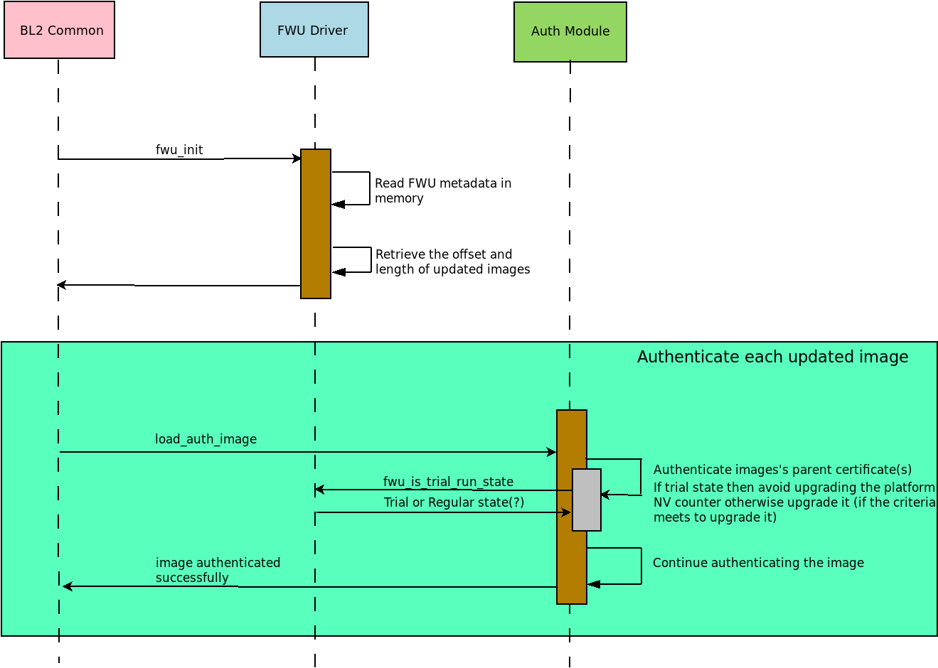

On subsequent reboot, the second stage Bootloader (BL2) performs the
following actions:
Read FWU metadata in memory
Retrieve the image specification (offset and length) of updated images present in non-volatile storage with the help of FWU metadata
Set these image specification in the corresponding I/O policies of the updated images using the FWU platform functions
plat_fwu_set_images_source()andplat_fwu_set_metadata_image_source(), please refer Porting GuideUse these I/O policies to read the images from this address into the memory
By default, the platform uses the active bank of non-volatile storage to boot
the images in trial state. If images pass through the authentication check
and also if the system successfully booted the Normal-world image then
Update Agent marks this update as accepted after further sanitisation
checking at Normal-world.
The second stage Bootloader (BL2) avoids upgrading the platform NV-counter until it’s been confirmed that given update is accepted.
The following sequence diagram shows platform-boot flow:
If the platform fails to boot from active bank due to any reasons such
as authentication failure or non-fuctionality of Normal-world software then the
watchdog will reset to give a chance to the platform to fix the issue. This
boot failure & reset sequence might be repeated up to trial state times.
After that, the platform can decide to boot from the previous_active_index
bank.
If the images still does not boot successfully from the previous_active_index
bank (e.g. due to ageing effect of non-volatile storage) then the platform can
choose firmware recovery mechanism TBBR Firmware Update (TBBR FWU) to bring system
back to life.
