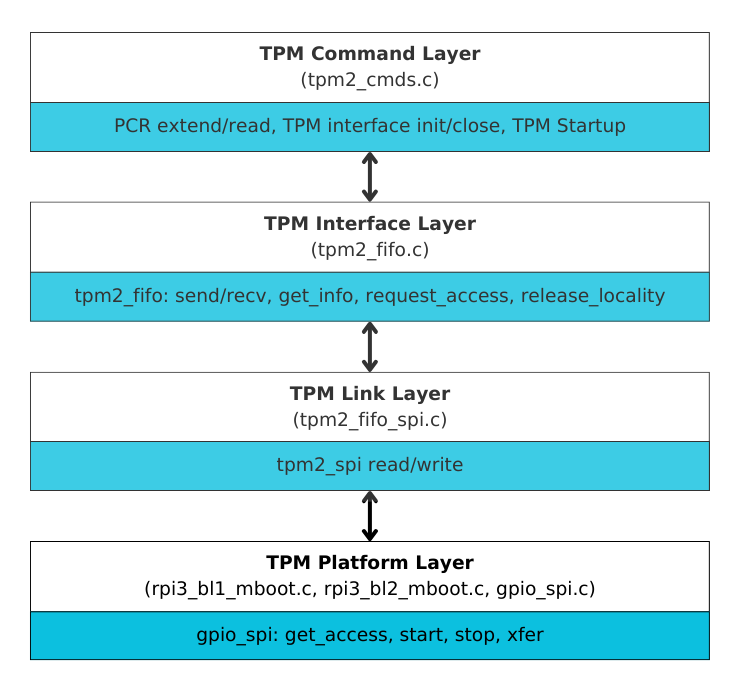

The Discrete TPM drivers are split up into four layers, each serving a distinct purpose in the overall architecture:
  • Command Layer: This layer provides various TPM commands based on the TCG TPM 2.0 Library Specification. It allows a system to initialize the TPM interface, perform a TPM startup, set up a locality for operations like PCR extend and read, and release the locality when finished.
  • Interface Layer: This layer handles sending and receiving TPM commands via a specific TPM interface like FIFO or CRB. It also includes functions such as getting information, requesting access, and relinquishing access, tailored to the specific interface.
  • Link Layer: Discrete TPMs may appear as a SPI, I2C, or memory mapped device. The link layer maps the command passed from the interface layer to the appropriate bus type. It includes hardware link read and write functions that use the platform bus interface to transfer commands.
  • Platform Layer: The platform layer implements the details of how to communicate to the TPM chip for a specific platform. The link layer uses the platform layer to read and write to the TPM.
Note
The command, interface, and link layers are implemented in common code in TF-A. The platform layer is implemented in platform specific code.
The following diagram illustrates the Discrete TPM driver stack for the Raspberry Pi 3 platform.
rpi3 dtpm driver stack
